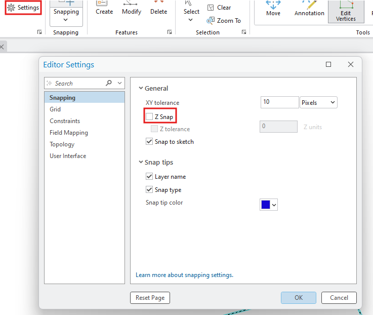

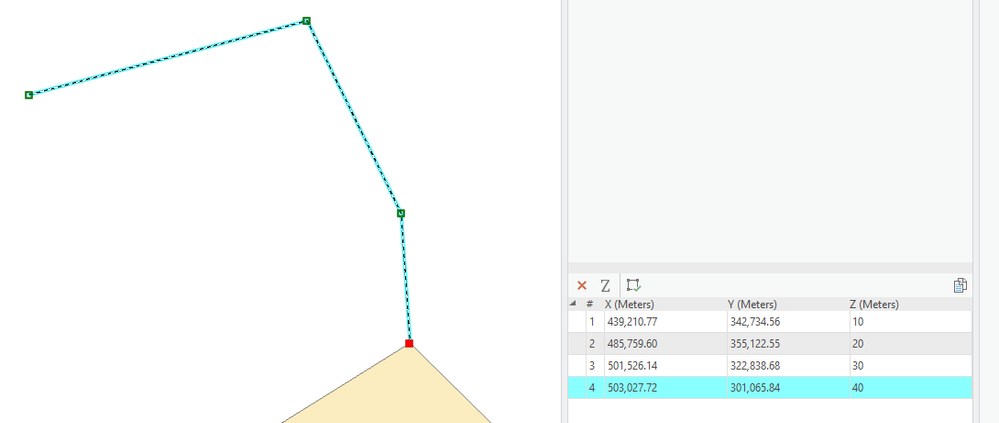

You need to change a snapping property to stop it taking on the polygon Z value. Here is my test scenario.
If I snap it without changing the setting it takes on the Z value of the vertex in the polygon, the problem you are experiencing.
You need to go to settings and UNTICK Z Snap
With that unchecked you get the correct result.
DuncanHornby
MVP Notable Contributor
