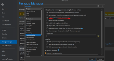

If you want to add final output of model to map: Check this option settings/options-

Hi,
everything is set as desrcibed. Can you check my workflow and test?
Again, i am getting right results from the editmode and running the model.
When running as geoprocessing tool - dubleclik on the model it runs and creates empty fetureclass of parcels. Tiff is created  but not added to a basemap (for test, you can release tiff cliping). Due to that i am unable to sherr the tool.
