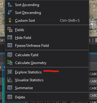

This is what I get when i right click a field name in Pro, the explore statistics and visualize statistics options are possibly what you are looking for but not seeing?

Would you mind clicking on that and sharing a screenshot to confirm that that's what I'm thinking of?

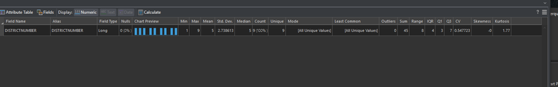

confirming i am on 3.2.2
it opens a new table like object rather than a pop up - docks it right next to the attribute table and it looks like this:

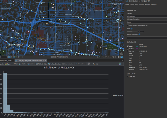

Your wish is granted: no, no new content is created that shows up in the contents window. If you use the 'visualize statistics' tool though you get a chart that opens up next to the attribute table and then a 'contents property' panel with some of the statistics information shown as well as in this screen shot. But still nothing new under the ToC.

It's closer to the old ArcMap statistics popup than the previous version, but I still prefer the ArcMap popup to the new Explore Statistics functionality (and I am not a Pro-hater... I've been using Pro for years and this is really the only thing I miss). The thing I miss most is that it was just a temporary popup that disappeared when you were done with it, rather than being another table you have to close. Also, if I remember correctly, it showed the total and the selection side by side, which was helpful for comparison purposes. The Explore Statistics table only shows the selection OR the total (when there is no selection). And you have to click Calculate to get it to refresh for each new selection. Plus the ArcMap popup showed everything in one glance, whereas with Explore Statistics I always have to scroll right to see the Sum column, which is what I want to see 90% of the time.

Its a little weird and cumbersome to me that there are two 'statistics' options - there doesn't seem to be anything in the 'visualize statistics' option that isn't in the 'explore statistics' option. The visualize tool lets you see the selection compared to the entire table and shows those in the side panel which i find more useful because i can see all of the information at a glance than the tabular view opened by the plain ol' explore tool which makes me have to scroll to see the data.

Yes - the information in the Visualize Statistic option is easier to see than the Explore Statistics option and it updates with new selections. However I very rarely (if ever) want the chart which opens up HUGE and if you close the chart then the statistics in the Chart Properties pane also disappears.  And it does put the chart into the TOC which is also annoying.  I don't want it there - I'm usually just checking sums of fields. The ArcMap version was definitely easier to use and to get info quickly.
