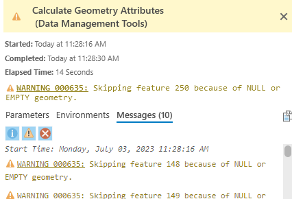

My first thought was to do calculate geometry but that gives me this and doesn't do me any good.

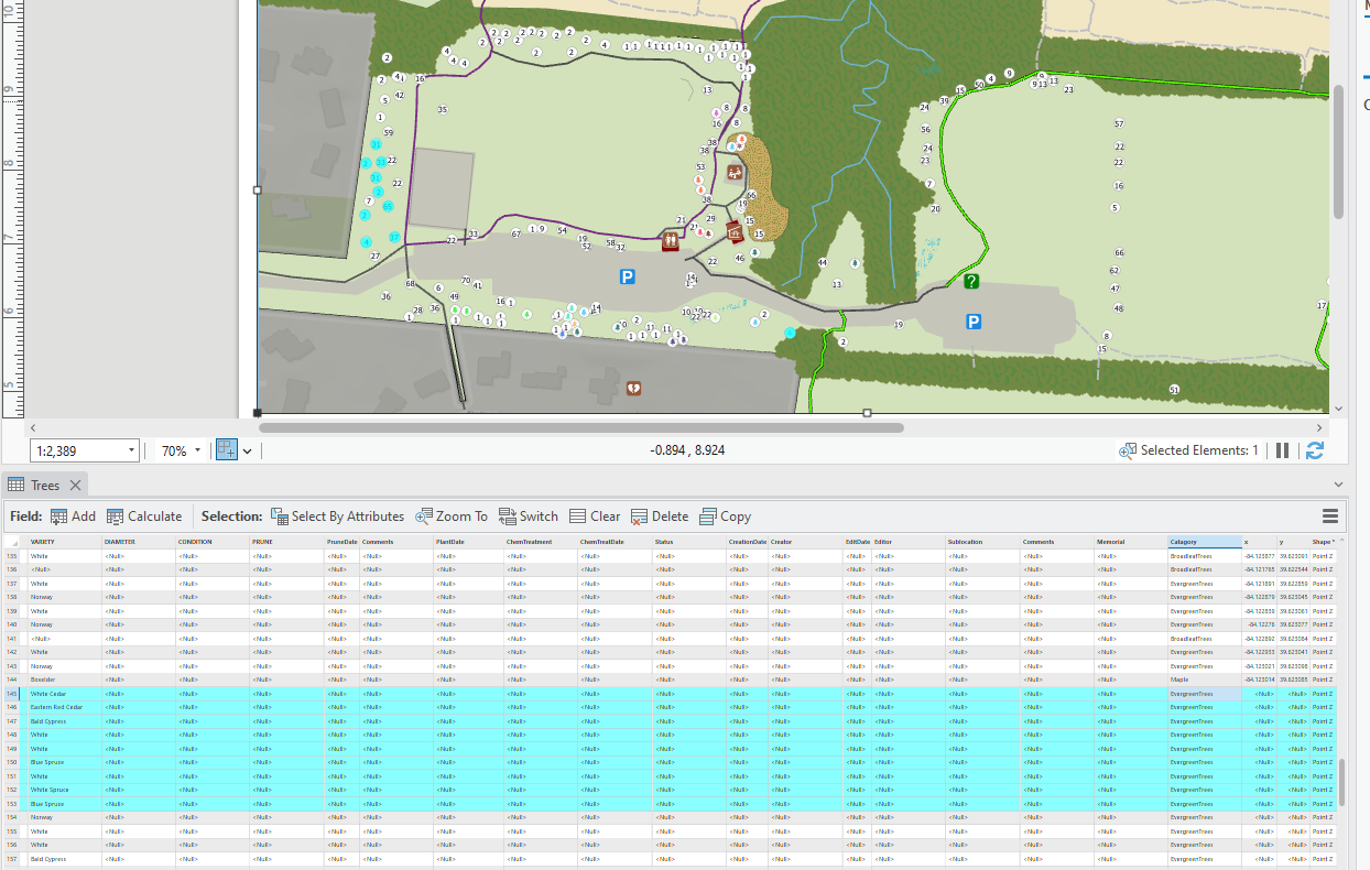

So the points are still loaded in pro but because the coordinates are now missing for some of them, those ones doesn't show up in any online services anymore. Is there a way to just popoulate the x and y feilds based on where the points are placed in the map automatically?
I cant export the feature to a new feautre because of the same issue, it won't show the points because there is no gemotetry saying where they go.

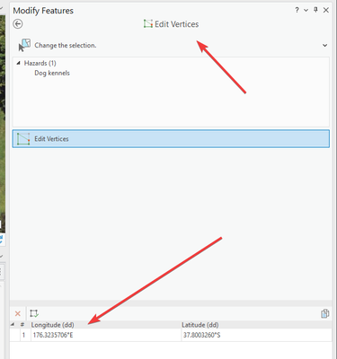

You can update the geometry manually in ArcGIS Pro.
First you need to identify them in the attribute table. You may be able to achieve this using attribute data depending on your dataset. Another option for null geometries is to add the data to a map, zoom out to the world and use the select tool to select everything you see. Records with null geometries will not be in the selection. Switch the selection and you have identified the records that need to be fixed.
Open the Attributes Pane and select one of these records.
In the lower half of the Attributes Pane you should see two tabs, one for Attributes and one for Geometry. Switch to the Geometry tab. You should see the vertices of the geometry.
Assuming the layer is editable, there will be clickable icons for Move and Edit Vertices. Click the Edit Vertices button. The Modify Features > Edit Vertices pane should open.
Update the vertex values and click the Finish button to apply the edits.
Done.
This works well for points. Lines and polygons take a little more effort to enter/update multiple vertices.

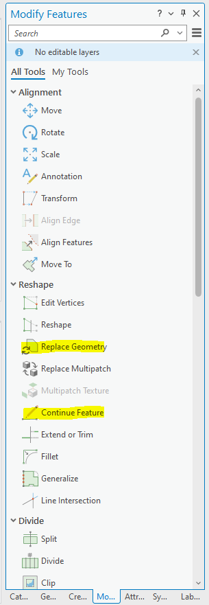

I think you can manually populate the geometry using the Replace Geometry or Continue Feature editing tools.

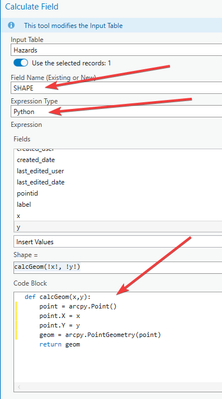

If you have attribute fields holding the correct x and y (or more complex info for lines/polygons) values, then you can use the Field Calculator GP tool to update the location of selected records by writing a small python snippet.
E.g.
