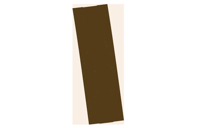

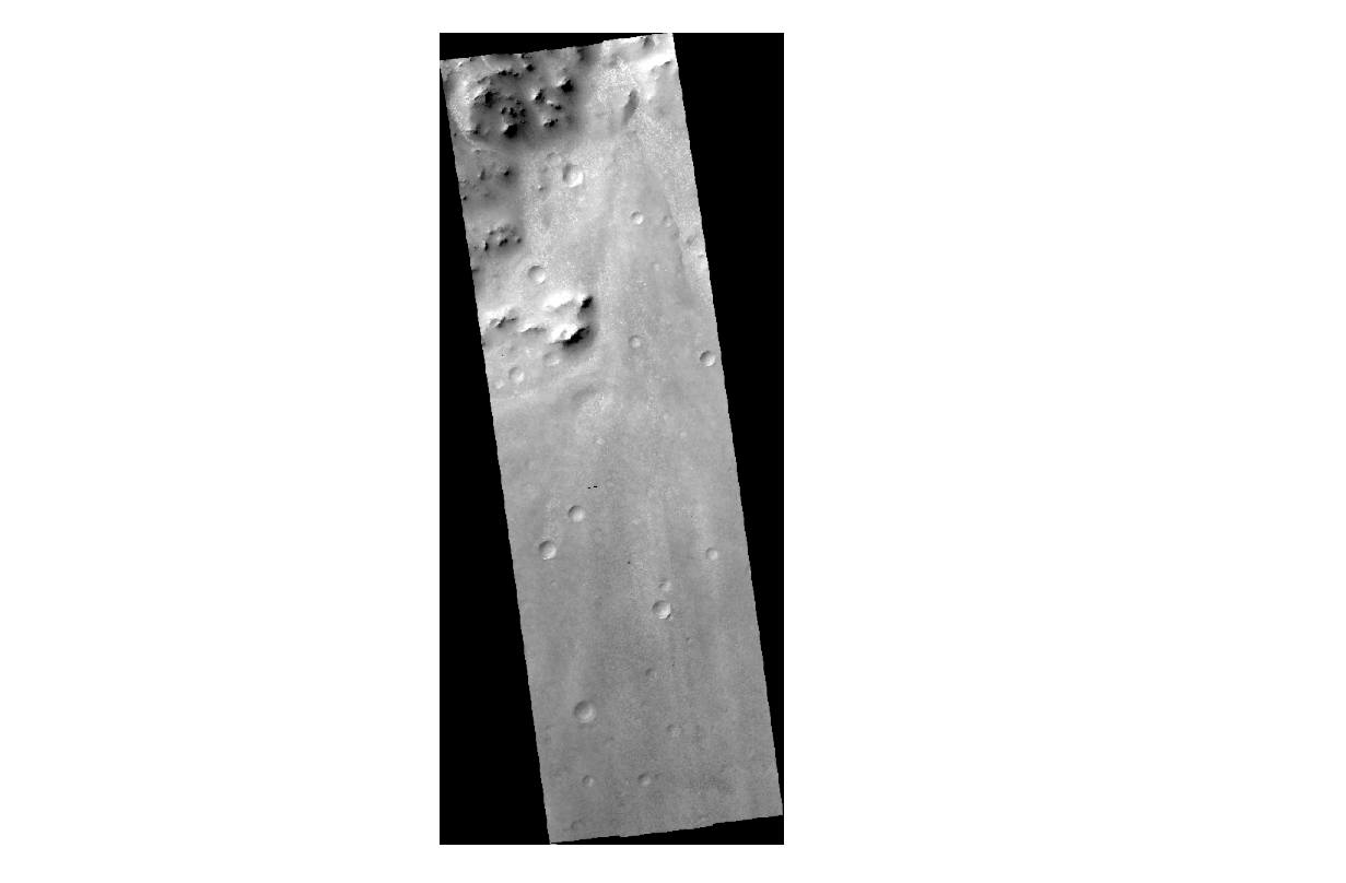

Hello, I am very green with ArcGIS Pro so I hope this is the correct place to ask. I would like to do some slope analysis on data I have downloaded from the HiRISE website (specifically this: https://www.uahirise.org/ESP_016671_1615). However when I run slope analysis on the JP2 file I download it comes out as a massive blob of colours. I've read that I would need to convert the .IMG file to something arc could read but I have no clue how to do this. Would anybody be able to help me?
Thanks 🙂
First image is what I have downloaded, seccond is... the blob

That looks like a hillshade product. You need a terrain model (showing actual elevation values at those locations) in order to do slope analysis.
Looks like they have some such models here:
https://www.uahirise.org/hiwish/maps/dtms.jsp
Once you have a DEM/DTM, you can add it to ArcGIS Pro and try the Slope tool on it.
You can convert raster file formats in Pro:
https://pro.arcgis.com/en/pro-app/3.1/help/data/imagery/export-or-convert-raster-datasets.htm

You can't run a slope analysis on imagery of different color band values (like a photo, or a landsat image). You need a raster that contains elevation values. If that image is a hillshade (it looks like it is), that implies that they have a corresponding DEM, because hillshades, like slopes are a product derived from a DEM.
