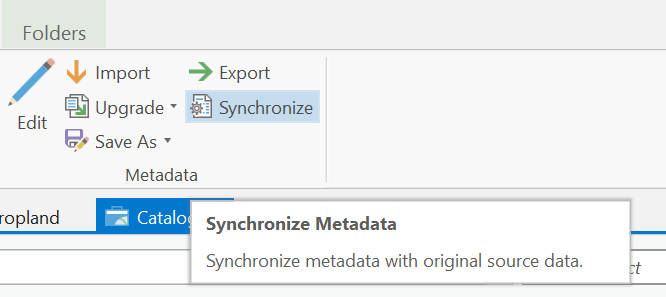

Solved it -- needed to hit the synchronized button. ArcGIS Pro does not update/synchronize whenever changes are being made (like defining a spatial reference).

I have a shapefile aaa.shp that did not have a defined spatial reference, I added spatial reference to the file using the Define Projection tool. The tool assigned the appropriate spatial reference to the aaa.shp file. Unfortunately, information about it did not appear in the metainformation. I tried doing Catalog > Metadata > Synchronize. Without any results. Of course, I use a metadata template that should display Spatial Reference information. I also tried to edit the metadata but I have no idea how to enter it correctly. Any ideas?...
Tomek
TomaszBartus
The issue has been resolved. The metadata not synchronize issue for some .shp files in ArcGIS Pro is the .shp.xml file. If such a problem occurs, remove the file from the folder and synchronize the metadata again. That does the trick.
