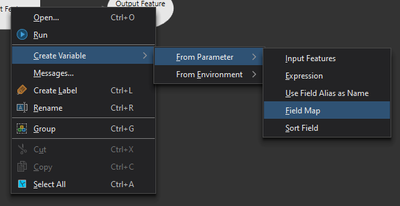

I came across this issue today which is wild it still hasn't been fixed. However I've found a solution!
Create a variable Field Map from the Export Features tool like below.
By doing this the values seem to persist between sessions. I haven't tested this with other tools using Field Map but presume the same would work.
