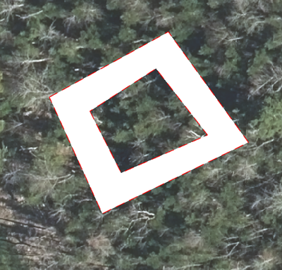

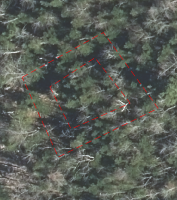

One method I use is to create a "doughnut" polygon such that the center of the polygon is what is to be shown and beyond is masked to the outer boundary.

The method I use is to create a polygon, but do not click F2 or finish when first boundary is drawn, instead right click and select Finish Part or F4.  Then create and interior or exterior polygon to the first polygon, then click Finish.  You will have a "doughnut" which can then be used to mask another layer.

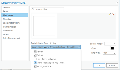

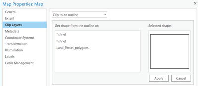

You could use Clip Layers (Map Properties)
Exclude the layers whose view you don't want to clip (including basemap).

This would be amazing, except it doesn't exclude my basemaps. It still clips everything
Cheyne
It does include basemaps, but it's automatically selected as an exclusion that needs to be unchecked.
