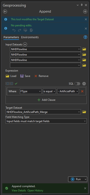

Hm, this also happened to me with NHDFlowline, must be something up there. Maybe it's the vertical coordinate system? There's no environment for that in the Merge tool. Clicking the error brought me to a general Esri support page with no information.
What worked for me after setting up a new feature class was using the source layers (from the disk) in the append tool and setting the expression that way rather than using the definition queried version in my map. I found that when I dragged them over from the map, they had null geometry on output (e.g. showed up in the table, but not the map - maybe because I had my symbol layers shut off?). I didn't need to make intermediate copies first.
