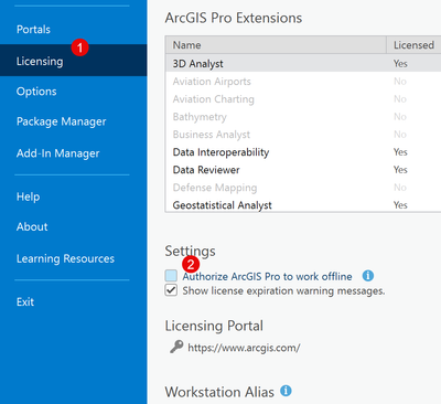

Was it installed to run offline?
ArcGIS Pro license types—ArcGIS Pro | Documentation
(see Offline license use)

Did you set it?
