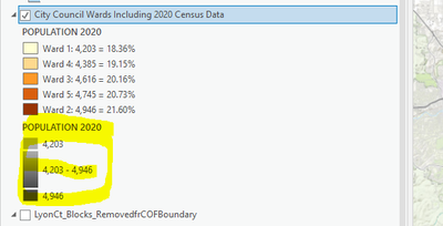

How do I get rid of this second grey Population symbology?

Are you using "vary symbology by attribute"? Then uncheck "Show Legend" from Symbology pane.
Check the steps to access the functionality in How To: Symbolize a feature layer using two types of symbology in ArcGIS Pro (esri.com)

That worked!!!! Thank you so much.  I have been trying to figure it out for almost 4 hours.
