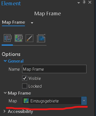

  • Make sure that you actually have connected your map frame to a map:

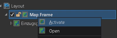

  • The map frame's extent is independent of the map's extent. So maybe your map frame just shows an empty part of your map. Activate the map frame to interact normally with the map, try to zoom to a layer:
