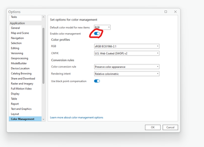

  I did however notice this new change (https://support.esri.com/en/technical-article/000027942)
which states you need to chose manually now in 3.0 the Color Depth and that was my issue.  Just in case others missed this little change, this was my issue with exporting to JPG...

JoelLogan
I was having this issue. When I enabled Color Management it started working for me again for both PDF and JPEGs.

AugustFroehlich
I just had this same export problem today and turning on the Color Management fixed the problem.
JonathanLee
I encountered the same issue. Exporting layout to PDF failed repeatedly. Enabled Color Management in Options and I was able to export successfully.
