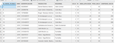

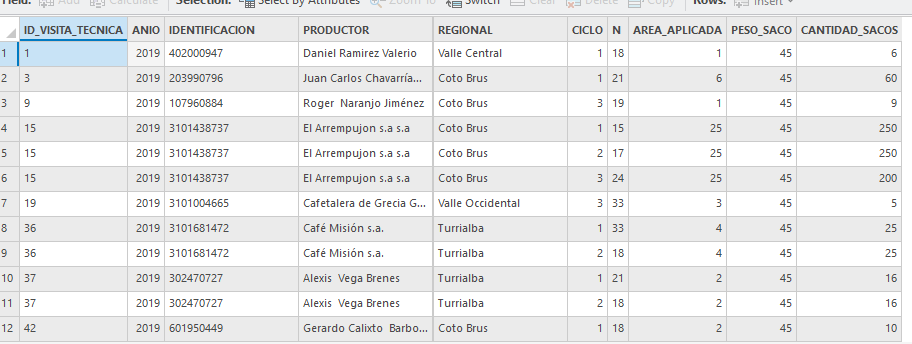

This is how I get the data using ArcGIS PRO interface (everything looks fine):

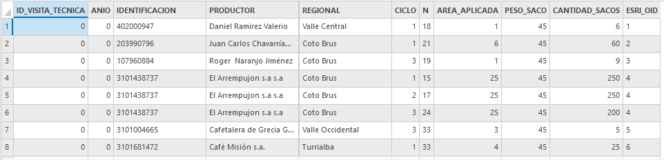

This is how I get the data using Arcpy on the Notebook, ArcGIS PRO console or using the python.exe enviroment:
This is my code:
conexion_oracle = '\conexion_oracle.sde'
query = "select ID_VISITA_TECNICA, CAST(ANIO AS INT) AS ANIO, IDENTIFICACION, PRODUCTOR, REGIONAL, CICLO, N, AREA_APLICADA, PESO_SACO, CANTIDAD_SACOS from CRCAFE.ICFSIG_VISITAS_FERTILIZANTES_VW"
arcpy.management.MakeQueryLayer(conexion_oracle, 'fertilizantes', query, 'ID_VISITA_TECNICA')

Are those two columns numbers expressed as text/string values? or are they just left justified?
... sort of retired...
DiegoMonge_Chinchilla
Hello Dan
Those colums are Integers
DanPatterson
MVP Esteemed Contributor
strange... it is almost like the justification has interpreted it as non-integer... try changing the justification in the source columns first otherwise, Tech Support might be your best bet
