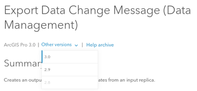

Export Data Change Message (Data Management)—ArcGIS Pro | Documentation
if so, on a lark try it as
arcpy.management.ExportDataChangeMessage(....
... sort of retired...
Luke_Pinner
MVP Regular Contributor
What version of ArcGIS Pro are you using?  That tool is only available in 2.9 or 3.0 (or ArcGIS Desktop, it looks like it was one of the tools that didn't make it into Pro initially)
