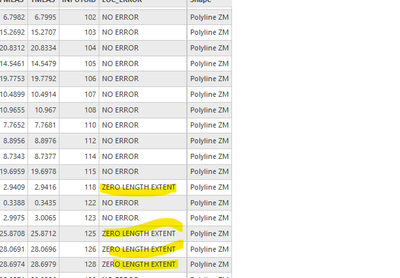

I am creating linear route events from a table that as some very small differences between fmeas and tmeas. The differences are not zero, but the lines are not being drawn. Is there a way to force the Make Route Event Layer tool to make lines for very short distances? We are crossing streams and need these segments.

Could you create a point route event layer instead of lines?
I wonder if you could post a similar question in the Esri Roads and Highways community, even though you're not using that product. I assume the Route Event Layer tool is still relavent to that community.
Does the map or layer have some sort of XY tolerance setting?
