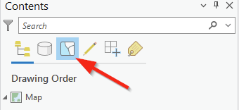

Would you be able to try and go to this menu here:
Once inside of that menu, I would attempt to uncheck the boxes of the images you would not like to select. That should help out! To get away from the red exclamation marks, you may go back to the Drawing Order, or the far left item in my screenshot.
