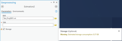

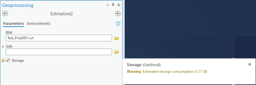

I have done this feature on a simple Scrip tool as testing, but it works with the normal tool (Not in Batch mode). So here's the code.
- as a testing phase i just give 1GB hard storage needed for each 100MB of BIM files.
Main code:
import arcpy
import os
def estimate_storage_consumption(bim_file):
    """Estimate storage consumption based on the size of the BIM file."""
    file_size_mb = os.path.getsize(bim_file) / (1024 * 1024)  # Convert bytes to MB
    estimated_storage_gb = (file_size_mb / 100) * 1  # 100MB of BIM = 1GB of storage
    return estimated_storage_gb
def main():
    # Get parameters from ArcGIS Pro
    bim_file = arcpy.GetParameterAsText(0)
    output_gdb = arcpy.GetParameterAsText(1)
    estimate_storage = arcpy.GetParameter(2)
    # If the checkbox is checked, estimate storage consumption
    if estimate_storage:
        estimated_storage_gb = estimate_storage_consumption(bim_file)
        arcpy.AddMessage(f"Estimated storage consumption: {estimated_storage_gb:.2f} GB")
    # Define the output dataset name and spatial reference (adjust as needed)
    out_dataset_name = "BIM_Dataset"
    coord_system_wkt = ""  # Specify your coordinate system WKT here or leave empty if not needed
    # Execute the BIMFileToGeodatabase tool
    arcpy.conversion.BIMFileToGeodatabase(
        in_bim_file_workspace=str(bim_file),
        out_gdb_path=output_gdb,
        out_dataset_name=out_dataset_name,
        spatial_reference=coord_system_wkt,
        identifier="",
        include_floorplan="EXCLUDE_FLOORPLAN"
if __name__ == "__main__":
    main()
Validation part:
import arcpy
import os
class ToolValidator:
    def __init__(self):
        # Set self.params for use in other validation methods.
        self.params = arcpy.GetParameterInfo()
    def initializeParameters(self):
        return
    def updateParameters(self):
        return
    def updateMessages(self):
        # Check if the checkbox (third parameter) is checked
        if self.params[2].value:
            bim_file = self.params[0].valueAsText
            if bim_file and os.path.isfile(bim_file):
                # Calculate the estimated storage consumption
                # Set the warning message on the checkbox parameter
                self.params[2].setWarningMessage(f"Estimated storage consumption: {estimated_storage_gb:.2f} GB")
            else:
                # Clear any messages if the BIM file is not valid
                self.params[2].clearMessage()
        else:
            # Clear the warning message if the checkbox is not checked
