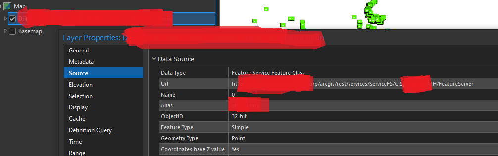

so, we have a layer's folder containing many lyrx files. All these layers files use published feature server as data source and of course some query definition.

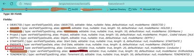

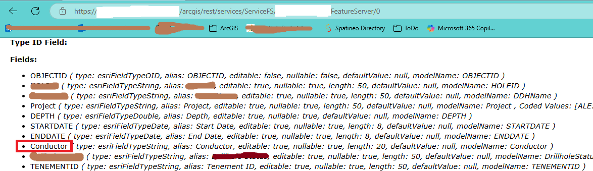

Recently we added new field to one of the published feature classes, we had to reorder the fields and once we overwrite, we can see the order of the field is indeed correct via rest url.

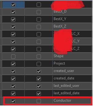

Now the layers that uses this published feature class as data source still shows the same old field order, moreover this new added field is at the very end/right. Seems like this lyrx file is still using the same old schema as checked via text editor.

LYRX source point to the FS
LYRX fields, you can see it's at bottom
REST URL
