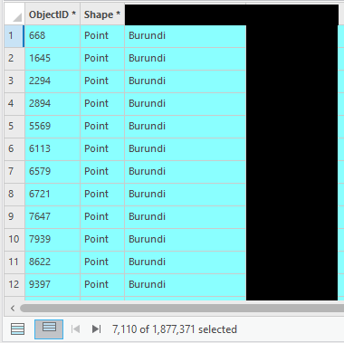

I have a point layer with roughly 2M records. When I open the layer's table, there's no data, but when I select by attribute, the selected records display all the data.
Here's what the table looks when I open it up (kindly forgive me for having to redact it):
And here's what I see when I make a selection:

In your graphic of the records selected in the attribute table, lower left, you have the Show Selected Records button selected.  Click the button to the left of that for Show All Records.  Then you'll see all records selected or not.
RachelK
Thanks for this suggestion! It worked and now all records are showing.
