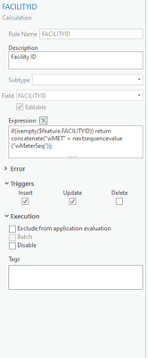

Hello,
I am trying to generate Facility IDs for my Water Meter feature class in ArcGIS Pro using Attribute Rules. This is the code I have so far, but I need to figure out how to add leading zeros, or decimal places to the ID. What I come up with is "wMET3" and I would like "wMET003".  Any insight would be greatly appreciated.
if(isempty($feature.FACILITYID)) return concatenate("wMET" + nextsequencevalue("wMeterSeq"));
