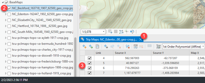

I have followed your suggestion but have not gotten what I had hoped for.  Here is a screen shot of the situation:
The first control table import I did was for Edenton which is reflected in the control table tab at 1.
Then I highlighted the Beckford raster at 2, clicked on the Import Control Table icon, selected the control table for Beckford and clicked OK.
Pro asked "Do you want to delete the existing control points?" so I selected Yes.  [The choices are: Yes, No, Cancel]
Pro then added the new control points for Beckford, at 3, but didn't assign those points to the Beckford raster so it was not properly placed on the the base map.  I was expecting a second tab to show that had Beckford in its title but that didn't happen.
The Edenton raster, however, remained properly placed and its control points in place, though now I'm not sure where to find its control point table.
I'm not sure what to make of this.  Clearly still I'm doing something incorrectly.
Thanks, Bill Cole
WilliamCole
I made a mistake saying that the Edenton raster was properly placed.  In reality the raster was placed based on the control points for the Beckford raster.  My apologies.
