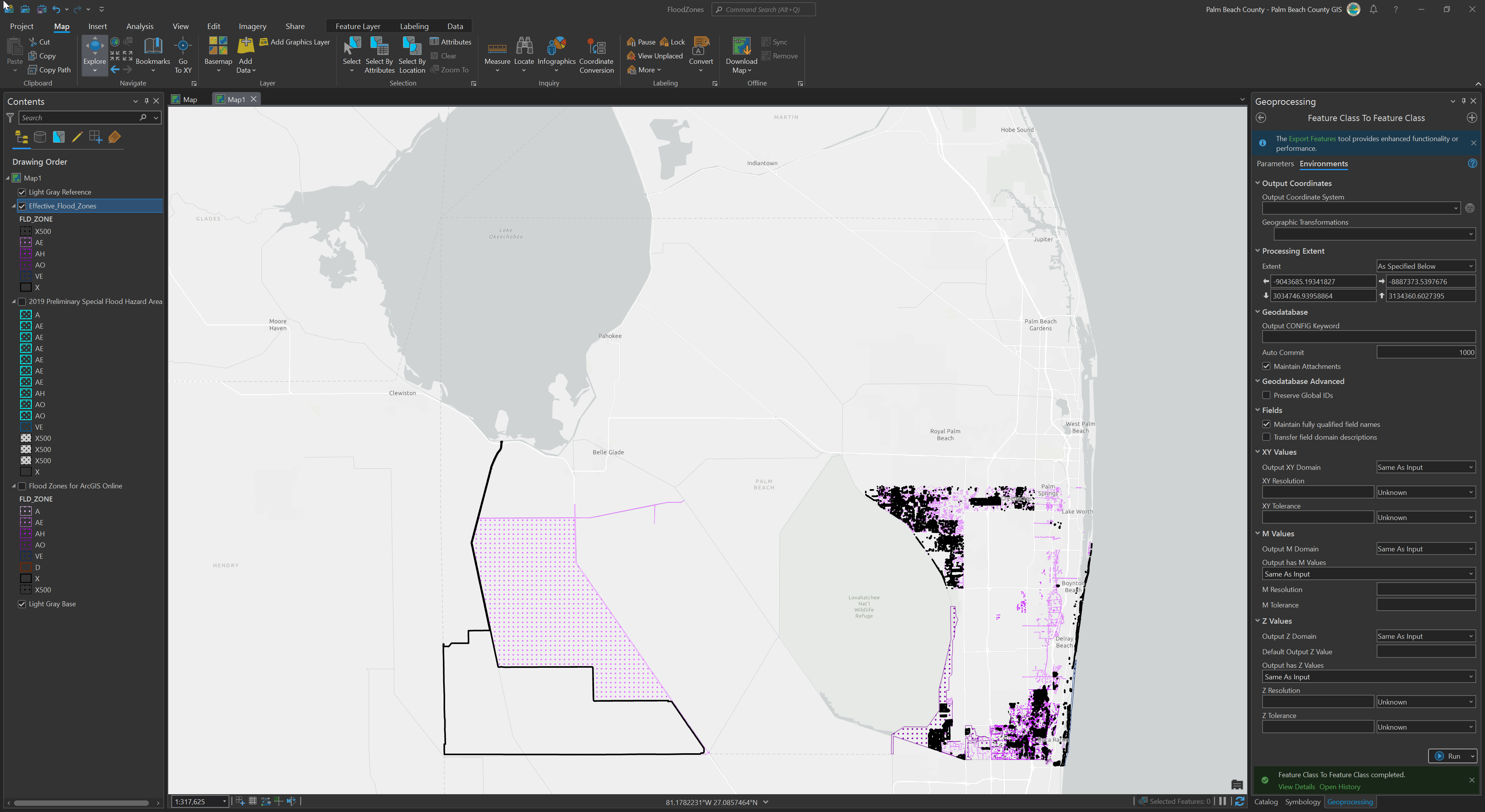

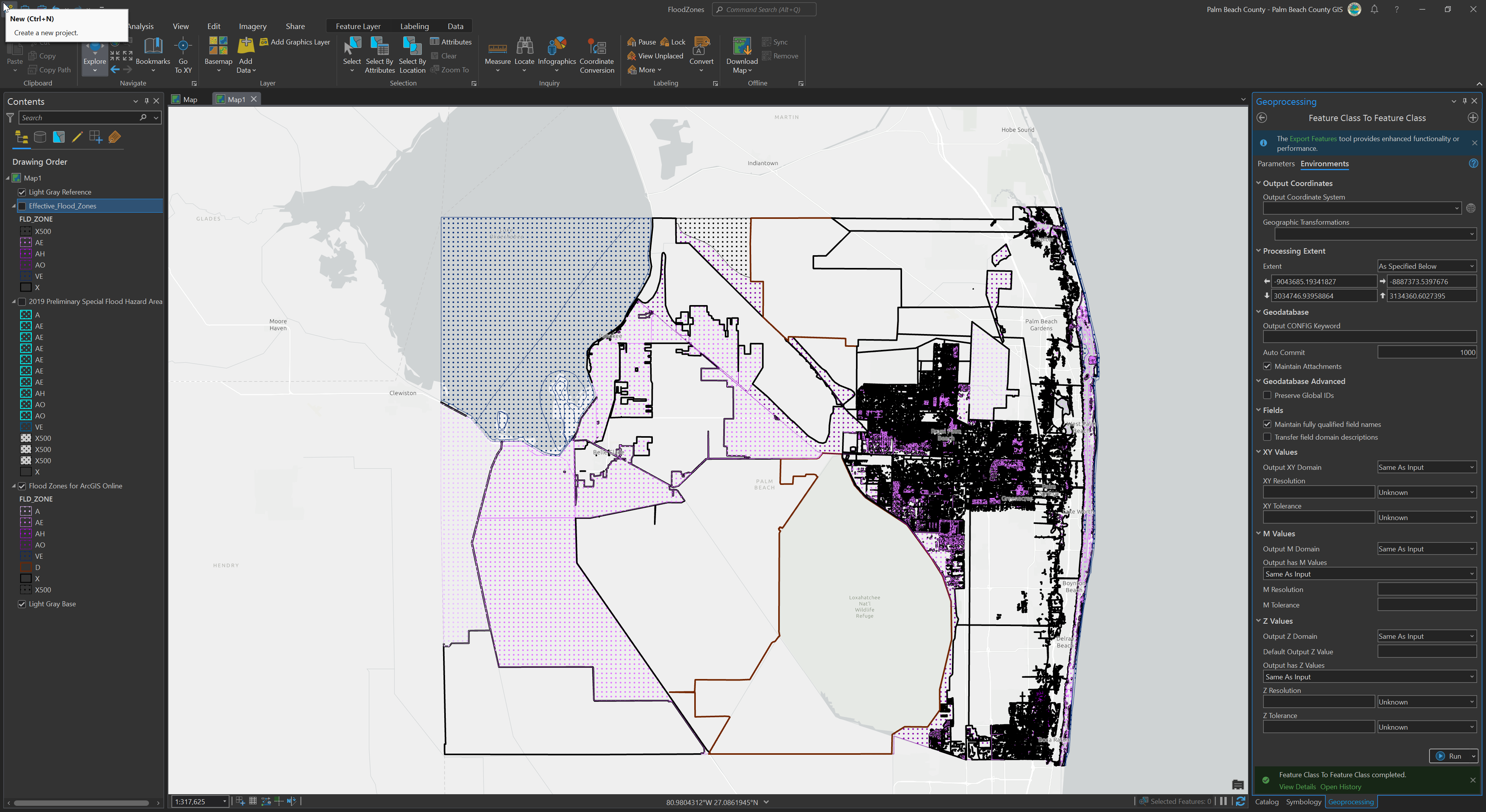

This one has me perplexed.  I've used the FC to FC tool many times before with no problem.
This time however, it's not copying all of the features (See pics below).
I've made sure I had nothing selected, I made sure that the extent I selected in copy included all features.
I tried just plane "copy features" tool and this failed.
Any suggestions as to how to correct this would be appreciated.
Original FC:
Copied FC:

Have you run Check Features: https://pro.arcgis.com/en/pro-app/latest/help/data/validating-data/invalid-geometry.htm or the Export Features tool (mentioned in the screenshot you posted): https://pro.arcgis.com/en/pro-app/latest/tool-reference/conversion/export-features.htm?
What is the data source of the flood hazard layer?
--- George T.
AngelaSchirck
The problem is I can't use the export features since this layer comes from a REST endpoint.  So I was using feature class to feature class to make a copy of it.  But it seems no matter what I do it's only copying about 30% of the features.
George_Thompson
Esri Notable Contributor
I was worried about that. See the comment from @SepheFox1 below. I would guess that is what you are encountering.
There is not a way around that unless they increase the export feature limit.
--- George T.
SepheFox1
Looks like you might be hitting up against 1000 feature limit for exporting.
https://community.esri.com/t5/arcgis-web-appbuilder-questions/record-return-limit-exporting-data-and...
