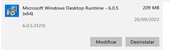

Thanks for your response, Dan. We have installed NET 6.0.4, but you specify NET 6.0.5 ( https://pro.arcgis.com/es/pro-app/latest/get-started/arcgis-pro-system-requirements.htm ) We're going to update NET to 6.0.5 and see if it makes any difference.

I can confirm that we have 6.0.5 installed but it makes no difference.
