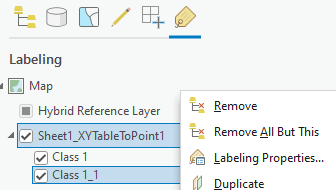

Dont want to take up your time so please ignore if you wish. As per photo attached -Not sure why I have duplicates of the labels in the contents pain under label? I had issues loading the XY table and did it a few times, maybe there is a double up of the data now on my geo database or map file? I have a lot to learn with GIS but if anything obvious springs to mind very grateful.

BarryNorthey
It looks as if you might have Duplicated the label classes. These can be managed by right clicking on the label classes you don't want and removing them.
NJ2021
Thats very helpful, yes thats what I did, thank you so much
