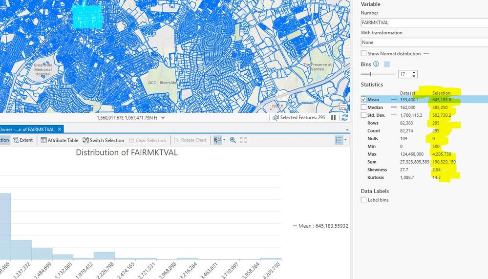

Example at 2.9 with Selected statistics highlighted in yellow:
Statistics on selected records in 2.9 Pro using Enterprise gDB.Statistics on selected records in 2.9 Pro using Enterprise gDB.

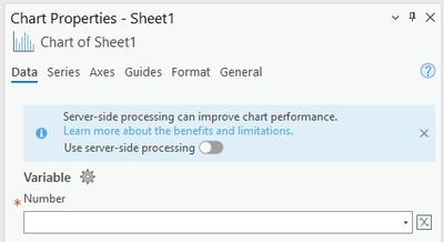

In Pro 3.2 we made a few improvements to the charts user experience when working with enterprise geodatabases. First, the performance enhancements are now turned off by default. This means that, by default, data from enterprise geodatabases are not subject to any limitations and selection is enabled. Second, in Pro 3.2 server-side processing can be turned on or off through a convenient toggle in the Chart Properties pane:

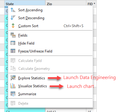

I also wanted to note that in Pro 3.2 we have updated the right-click menu in the attribute table to include an option that launches the Data Engineering view:
We hope this will make it more convenient to use Data Engineering to view summary statistics.
