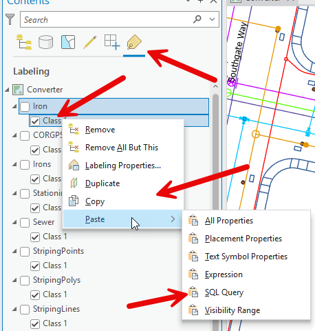

RhettZufelt
MVP Notable Contributor
You can also select the labeling tab in the TOC and copy the label class(es), then it lets you choose which options to paste to other classes:
R_
DaveMartin1
Rhett, I like your suggestion. I selected the labeling tab, and selected copy with multiple Anno classes selected. I'm not clear about some things beyond that:
1. You said 'it lets you choose which options to paste...'.  In my example, I'm not seeing how to get the Properties options to show up (where your 3rd red arrow is pointing).  I've got 5-6 classes associated with a single  streetmidline feature, each class being for different sizing at different scales.
2. Does your approach work when there are multiple classes selected from a single FC?
Please advise.
Thanks
JesseWickizer
No, you can only copy 1 label class at a time so the clipboard will store the properties of that one label class. But you can select multiple label classes to paste those properties to.
