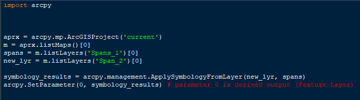

Script example that only works if run as a standalone script:

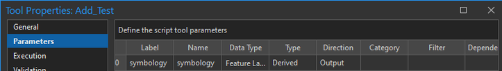

From the tool doc:
To see the symbology created in a script tool, the tool must include the layer as a derived output parameter.
Have a great day!
Johannes

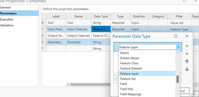

Are you using a custom toolbox where you can specify the parameter type from a dialog or is this a parameter-less tool?  A toolbox script will behave properly if you define the parameters in the tool and select them from the dialog like this?
... sort of retired...
by Anonymous User
Not applicable
I was grabbing the layers through the map.listLayers() method because one of them will be an in-memory layer that I created in my script, not a user input.
But I just tried making them both user input parameters (Feature Layers), and it still didn't work.

From the tool doc:
Have a great day!
Johannes

Ahh, thanks! I guess I should have read the doc more thoroughly. I've been avoiding derived parameters, because I didn't understand them.
Here's the code that works.

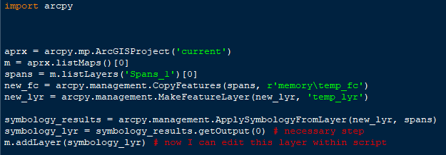

by Anonymous User
Not applicable
Actually, I found a better solution for my purposes. I was having an issue with the derived output adding a second copy of the layer being affected, when that layer was an in-memory layer. When I changed so that it wasn't added to the map at all until the derived output from the symbology tool, then I realized that the derived output doesn't get added to the map until the script ends. This is a problem because I need to apply symbology, and then edit it within the same script.
Here's the new method that works better when your affected layer is an in-memory layer: no duplication, and immediately added to map.
I know this seems like a pointless script... it's just a fragment of a larger script.
