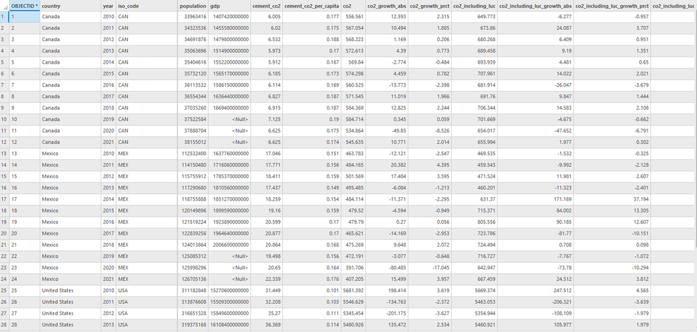

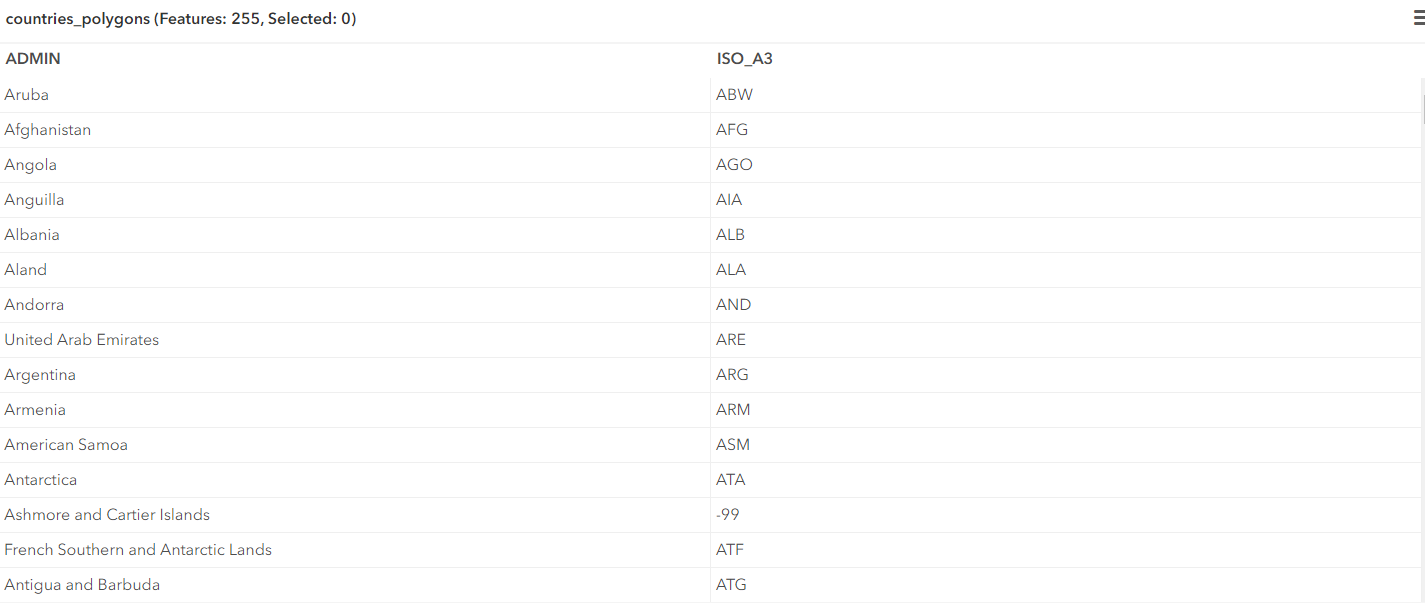

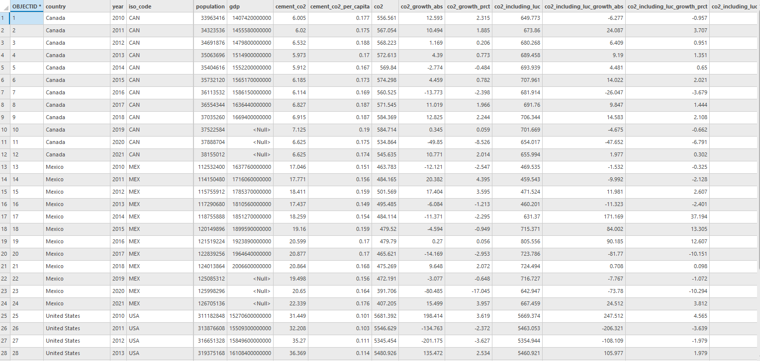

Hi,I am trying to Join A feature service with an excel sheet's data using Add Join tool and both of them have a field in common below is the snippet:
now = int(dt.datetime.now().timestamp())
file_name='data_table'+str(now)
file_path=os.path.join(os.getcwd(),"MyProject1.gdb",file_name)
arcpy.conversion.ExcelToTable(xlsx_file_path, file_path)
arcpy.MakeFeatureLayer_management("https://services7.arcgis.com/yxpZft6sXAxt864n/arcgis/rest/services/countries/FeatureServer/0", out_layer='fclyr')
arcpy.MakeTableView_management(file_path, 'table_view')
arcpy.management.AddJoin('fclyr', 'ISO_A3',file_path, 'iso_code')

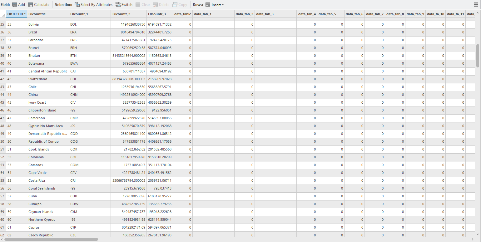

Here, I am able to create the join but not able to map one to many relationship between the tables, also the join created as a result has random field namesimage.pngimage.pngimage.png
can anyone help?
