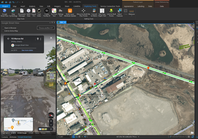

OK, so here is my version of a StreetView tool.  This was compiled for Pro 2.9, so it will not work in 3.x.  I only have access to 3.0 and one of the libraries I use is not compatible, so I will have to wait till I have access to 3.1 before I can post an update.
AddIn and code available here:
https://github.com/bbulla24/ArcProStreetviewTool
Jimmy_Simpson
Based on @BrianBulla's code, I have re-wrote the original tool to use a dockpane and the built in WebView2 browser with Pro 3.x. This release is only for 3.1 though. I also worked on the "Link to Active Map" and now the map and street view should stay in sync with each other. Also included a direction arrow on the map when you pan around in street view to show what direction you are looking in. Can't promise this is completely stable.
https://github.com/jsimpson746/arcgis-pro-addins/releases
