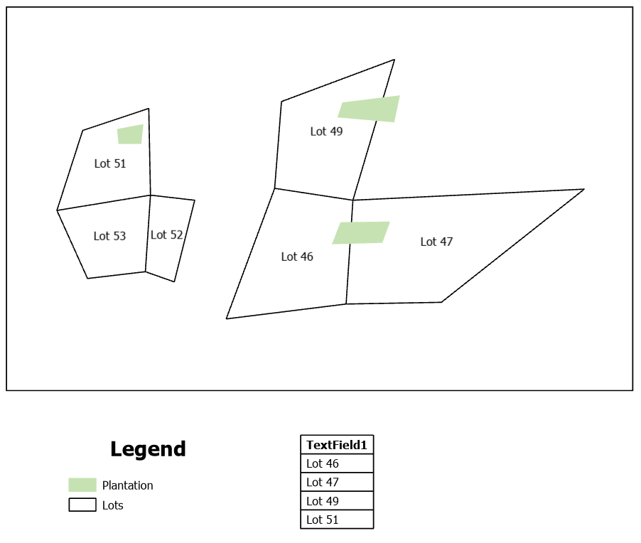

I'd like to add some dynamic text to a layout that returns attribute values from a layer, but instead of returning all values, visible values or values from an expression, I would like to try write an arcade expression that only returns values where the source layer intersects with another layer which has a filter applied to it. My example would be returning Lot numbers from a Land Parcel layer for lots that have plantation areas on them, and not the neighbouring lots.
I've tried using Intersects() and the $map and $datastore profiles to lookup my plantation layer, but my understanding is the dynamic text doesn't recognise the $map profile and the $datastore profile only returns layers in a feature service.
I've also looked at including a dynamic table, but I can't format that to read as text, and also can't remove duplicate values.

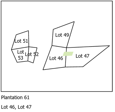

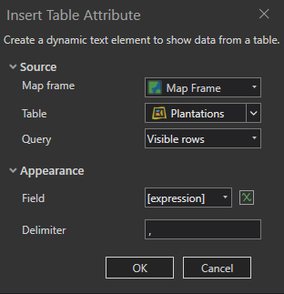

This will list all Lots numbers (TextField1 in my layer) intersected by Plantations (note that you insert a table attribute for the plantation layer):
var lots = FeaturesetByName($datastore, "Lots")
var i_lots = Intersects($feature, lots)
var lot_names = []
for(var lot in i_lots) {
    Push(lot_names, lot.TextField1)
return Concatenate(lot_names, ", ")
This works fine if you have only one plantation:

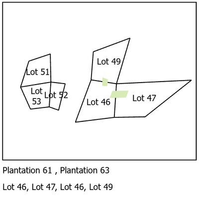

With multiple plantations on different lots, the lot numbers will be unsorted:
With multiple plantations on the same lots, the lot numbers will be duplicated:

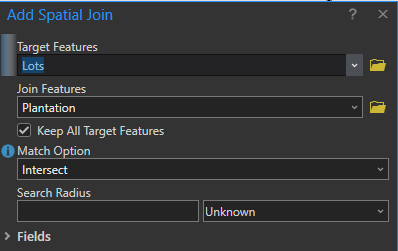

Aren't you describing a Spatial Join?
  • add a Spatial Join to your Lots layer (intersect with Plantation layer, keep all features)
  • This will add a column "Join_Count"
  • in the layout, add a table frame for the joined Lots layer, filter by Join_Count
