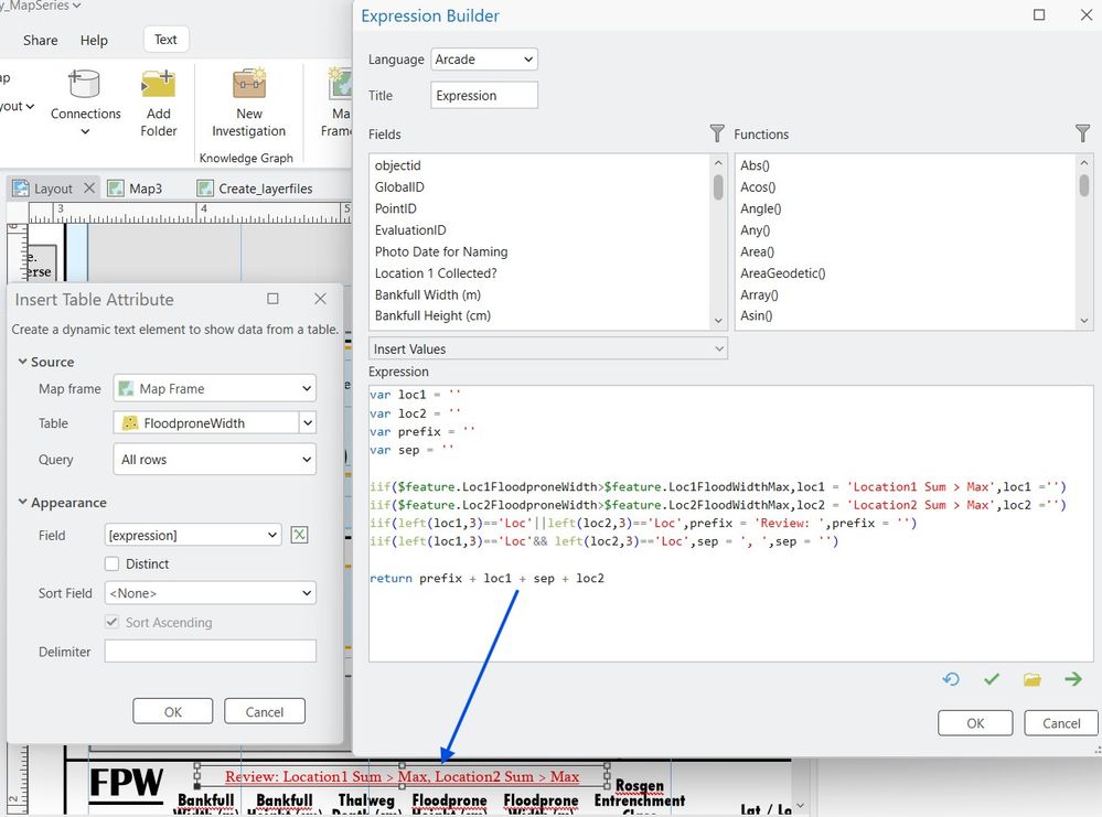

If your looking for dynamic text in a layout, use the arcade expression option in dynamic text.
This arcade profile was heavily downgraded in the recent 3.5 pro upgrade when many feature set calls that have worked for years were disabled. That said, you can still use arcade to manipulate on the fly content based off a single map series record, but you can no longer aggregate data across multiple map series records like a repeat table or pull in information from other layers to drive your label. They claim it is for performance but there appears to be some confusion on labeling features on a map vs dynamic text for a map series layout.
Here is a recent idea that was made to add $datastore and $map profile functionally back to layouts.
Idea: Arcade - Add $datastore and $map to the Layout Profile
