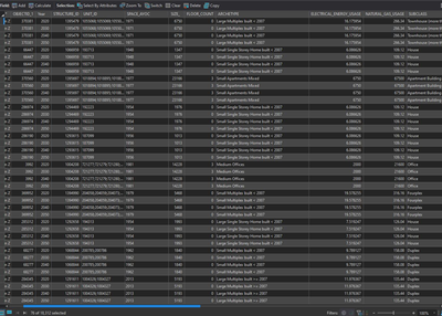

There are 2 main fields present in the data set that will be involved in building scenarios !Year! and !ARCHETYPE! (See Image Year and Archetype fields in dataset.jpeg)

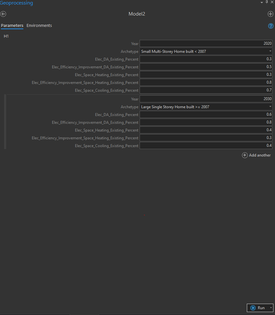

So, I have created a Variable in Model builder with “Table of Values “option, this option gives me a chance to build scenarios using multiple values for same variable, as shown in image (Table of Values Variable.jpeg). Year and Archetype are the fields as well as variable.

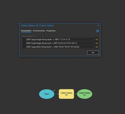

How do I separate OR use all these variables with their names (See image Collect Values from Variable.jpeg) so that I could use them in calculations later? If I use Collect Values tool, I need to split these values. I am not so good with Python so If I need to call a function to split these values, I will need help with the function.

So I created a Table of Values Variable in model builder and i also added Year and Archetype in it. Now my question is there a way (Possibly a Python code or function) to select rows based on the values provided in Year and Archetype fields here in the interface.

The objective of this tool that i am trying to create is the to provide user to build future scenarios based on !Years! and !Archetype! sets and each set would have its own variable values. just like you see in the picture above, It would be a good learning opportunity for me to see if python script can provide that sort of functionality and user interaction.

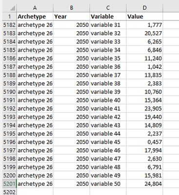

I suggested creating a table with the 5200 records for all archetype, year and variable combinations. Like this:
(I used this snippet to create the content:)

I converted the data to an ArcGIS table in a FGDB and ow you can read the values either into a dictionary and query directly on archetype and year (if you are planning to use all the data) or simply load the variables related to a specified archetype and year using a query definition while reading the table.

When I looked at your features, I noticed that you have 4 copies of the same geometry (one for each year( and you have repetitions of multiple archetypes for a large part of the data. I don't quite see how you are planning to connect this data to the features you have.
Can you explain more about this? What is a scenario supposed to return?
HussainMalik1
Hi @XanderBakker
The  raw dataset that I  initially got had no repetition in it since we are doing future scenario modelling so i created a time series data and added Year in it. and since we are forecasting building emissions from 2020 to 2050 with 10 years step interval that's why we got 4 of each !StructureID! which is a unique field.
