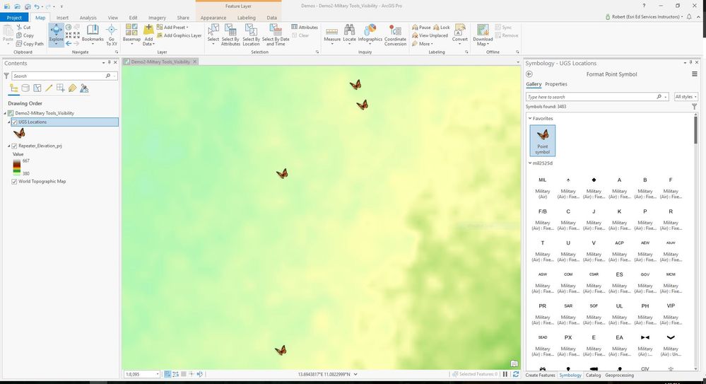

To add to Jayanta's message about Importing an image as a style in ArcGIS Pro, you could download these free *.png files of butterflys to make your own butterfly.stylx file and use that in your ArcGIS Pro maps.
