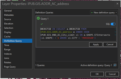

I think I see what the seeking to do and there was a way in ArcMap to add a subquery inside the definition query if both feature classes lived in an enterprise geodatabase. I attempted this in Pro and it does validate the query but on saving it, it never applies. Then, when you open up the definition query editor, it shows no active definition queries. So I agree with your desire and others that it would be nice to have a way to limit the features by a spatial definition query.
