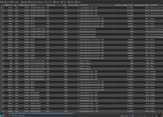

I am building a tool to calculate Green House Gas emission from the city buildings. And there are 25 to 30 Variables that are involved in the calculations and there are around 90 new calculated fields that will be added in the process to incorporate these variables.
There are 2 main fields present in the data set that will be involved in building scenarios !Year! and !ARCHETYPE! (See Image Year and Archetype fields in dataset.jpeg)

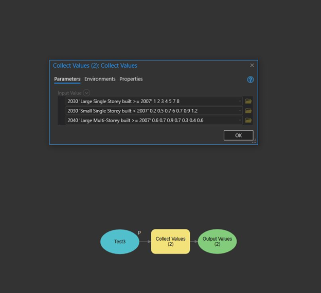

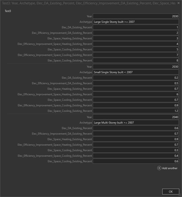

So, I have created a Variable in Model builder with “Table of Values “option, this option gives me a chance to build scenarios using multiple values for same variable, as shown in image (Table of Values Variable.jpeg). Year and Archetype are the fields as well as variable.
My first Question:
How do I select data which matches my %Year% and %Archetype% variable values in dataset, since !Year! and !ARCHETYPE! fields are present in the dataset.
My second Question:
How do I separate OR use all these variables with their names (See image Collect Values from Variable.jpeg) so that I could use them in calculations later? If I use Collect Values tool, I need to split these values. I am not so good with Python so If I need to call a function to split these values, I will need help with the function.
