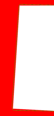

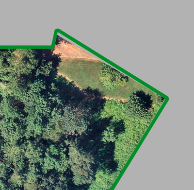

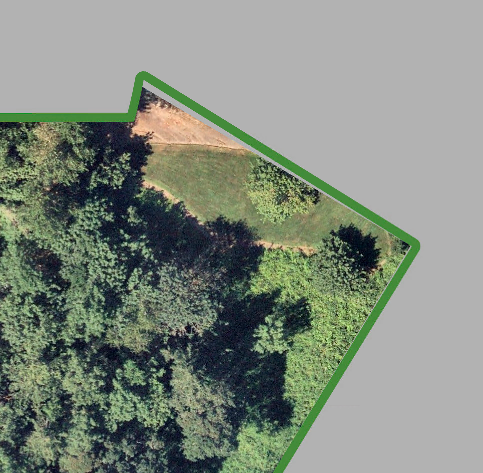

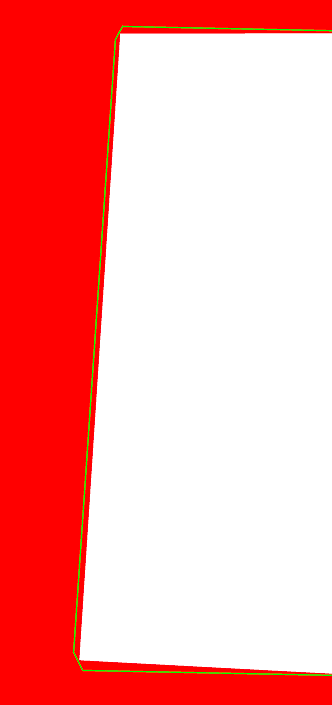

I'm using the buffer tool, on polygons, using 2.9.6, with the option to Exclude the input polygon from the buffer, with a dissolve by attribute, and nearly every buffer is inexact.  It's leaving slivers inside the polygon.  I tried setting a low tolerance, I tried geodesic and planar all same result.
Excuse my gaudy symbology.
How to I get this to work properly?  There are only 90 polygons and I'm most of the way through editing them but this seems like kind of a big deal if buffers are being drawn incorrectly.

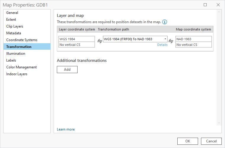

I wonder if you do not have a geographic transformation applied?  Right-click on your Map name in the Contents pane, click Properties, followed by Transformation.  In the Transformation pane, is there a geographic transformation applied?
m3
I do but removing it makes no difference.

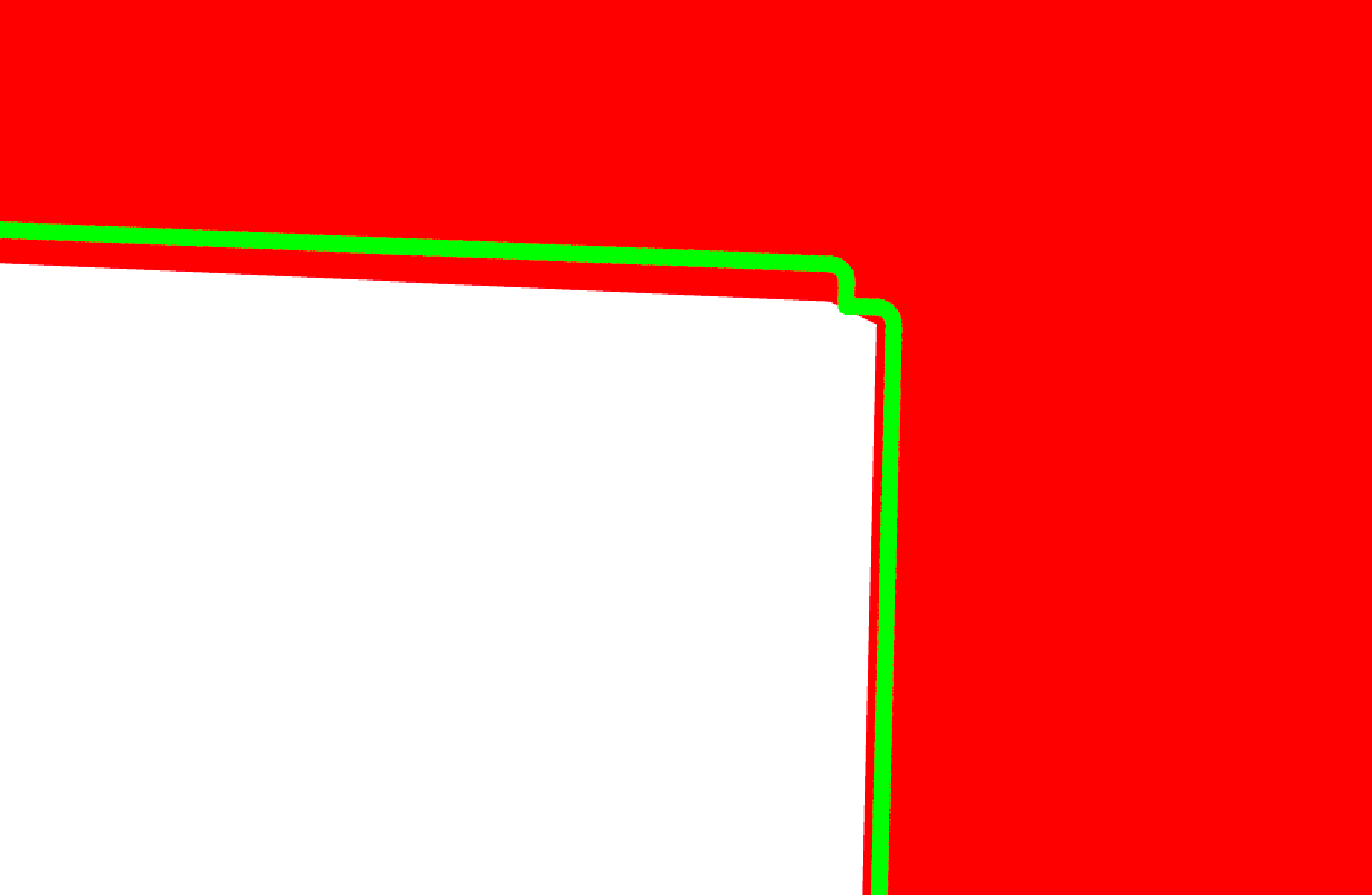

I was also just testing in ArcMap without a transformation and get similar results, it seems to be related to the size of the buffer which in this case is 2 miles.  Bringing down to 200 feet works but then I have to do a series of buffers to merge to get my 2 mile result. It's a specific use case (cartographic overlay in map series) but nonetheless, not an expected result.
Still it seems kind of a weird bug to have run up against after all these years.
