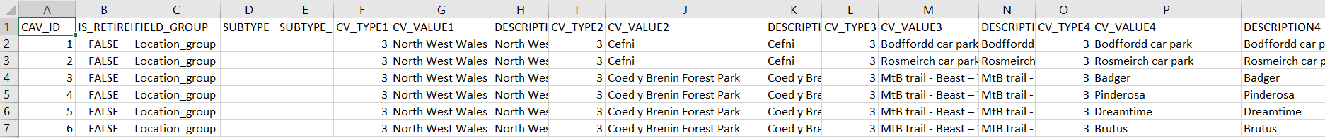

and I have added my CV.csv which looks like this:

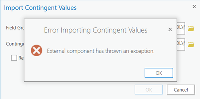

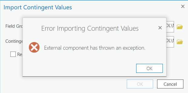

When i click OK it results in this error:
Is this a bug / How do i resolve this?

@OliverIshmael  - so in reviewing a support case from a customer, they were experiencing the same thing as you.  The way they resolved the issue was calculating the SUBTYPE field to be zero's for all rows in the *.csv file if there was no subtype to begin with in the feature class.  Then the Import Contingent Values GP tool should work.
