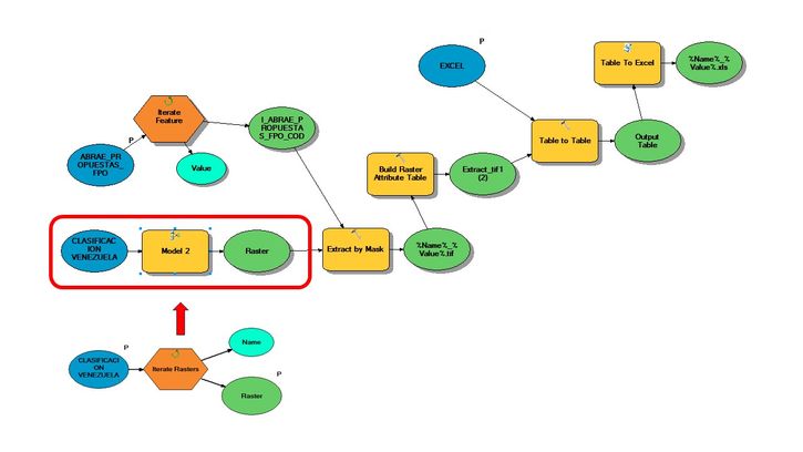

Hello! I have a shapefile with multiple polygons and a folder containing several rasters. I would like to create 2 iterations to cut each raster in the folder with each polygon in the shapefile. I've been trying, but I haven't been able to achieve it. I hope one of you can help me.

@RaynerCastro - this can be accomplished using a submodel approach as described here.
