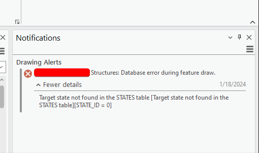

I have one user that has been receiving these drawing alerts from versioned datasets in ArcGIS Pro 3.2.1. It has been very inconsistent and impossible to reproduce. Typically it happens while the user is editing their version. At random times the notifications pane can be flooded with these drawing alerts. So far it is this one user on one machine, in several APRXs and three Enterprise Geodatabases. Typically switching back to the default version or restarting Pro fixes the problem. There has been no loss in data. Does anybody have any thoughts?

You may want to look at this post: https://community.esri.com/t5/arcgis-pro-questions/arcgis-pro-3-2-drawing-alerts-returning-state-id/...
It is a little long, but it appears a defect has been logged: https://support.esri.com/en-us/bug/database-error-during-feature-draw-target-state-not-fou-bug-00016...
I would contact technical support to be added to the issue and make sure it is the same behavior.

Thanks for the links! I had nothing show up in my search at all, guess I was being too specific. These are very helpful. It sounds like like the same issue.
