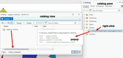

Could you please insert a screensot that shows the horizontal scrollbar for the catalog?
Jamal Numan
DanPatterson
MVP Esteemed Contributor
I floated the catalog view to get it beside the catalog pane
notice that the "view" has the scrollbar and the pane uses pop-ups to access the information
