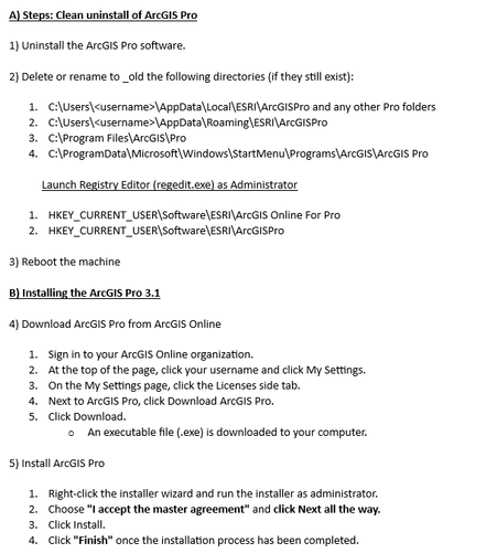

Problem solved!
The solution, after working with ESRI tech support, was doing a somewhat more involved uninstall-reinstall (I had tried simply re-installing without doing an explicit uninstall and that didn't work). Image below shows the steps we did:
So I think my original issue was due to some bug with the specific installation I had. Either way am glad it's fixed!

Problem solved!
