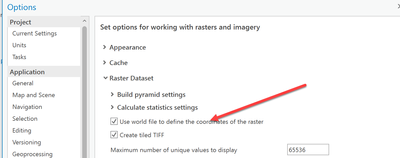

and do you have Pro set to this in the options, raster section?
