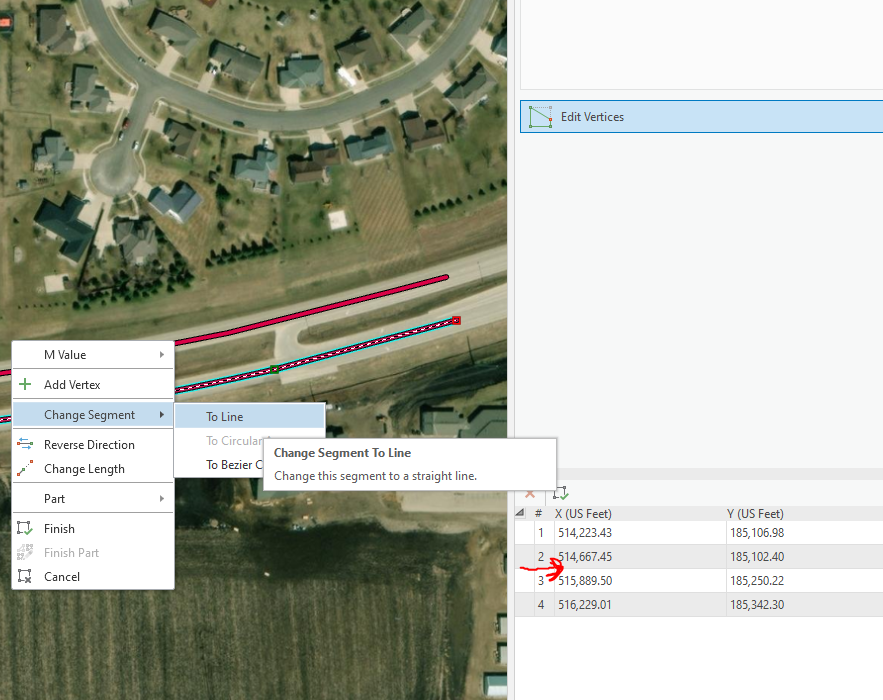

Hello,
I am trying to identify true curve segments within a File Geodatabase layer. I know we can manually see if a single segment is a curve by selecting editing vertices in the edit tools pane, then for each segment within a feature we can right click and select "Change Segment."  From there we can see if the segment is already a line, or a  circular arc (true curve).  This seems like a lot of drilling down and I suspect there may be a cleaner way to identify curves.
Questions:
  • The edit vertices tool displays the xy coordinates for each vertex in a line each line / feature which is shown in the bottom right of the image.  However, it does not identify if a segment between the vertices are a strait line or curve.  Is this possible?  In the example the segment between vertex 2 and 3 is a true curve.
  • Within a layer can we bulk identify lines or segments that contain a true curve?
  • As a bonus can we identify the properties of a curve such as the radius, arc length, etc?
Thanks!
