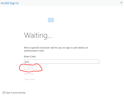

Greetings,
I have a project aprx that is signed into an Enterprise portal that times out regularly.  Upon opening the project I get the sign-in dialogue followed by an internet browser opening to the Enterprise Portal.  The Enterprise Portal login in successful and an OAuth2 Approval code is generated.  I copy/paste the code back into ArcGIS Pro but the submit button stays grayed out.  Closing the sign-in dialogue does not continue to open the project, rather another ArcGIS sign-in dialogue pops up, and I'm stuck in a loop unable to open the project at all.  Any ideas?
Thank you,
Tyler
Robert_LeClair
Esri Esteemed Contributor
Tyler - give this workflow a go to escape the sign-in loop:
  1. Go to Start > search for Regedit
  2. Navigate to HKEY_CURRENT_USER > SOFTWARE.
  3. Find ESRI folder and rename it to ESRI_OLD to reset the registries.
  4. Relaunch ArcGIS Pro, and sign in.
From previous support cases, this seems to fix the issue.
JoshBerna
Thanks @Robert_LeClair,
This ended up solving this issue for me.
TylerT
Thx @Robert_LeClair.  I'll give that a go and let you know.  Tyler
