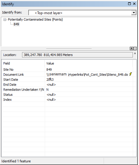

Hi,
links to Word Documents located on a server using a UNC path seem to work absolutely fine as Hyperlinks in ArcMap by clicking the yellow flash icon but in ArcGIS Pro 2.7.1 they are not clickable to link.

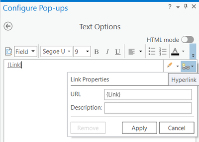

In ArcGIS Pro, you need to configure the popup. Insert a hyperlink as a text element

CMcDonald
Thanks, that helped.
Did not spot the carrot and you also have to highlight the text you want in order to configure the URL.  I hope this is improved by ESRI in the future, in ArcMap no config was required - it just linked!

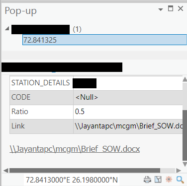

I think this method is cleaner.Complete HTML as the field value. FAQ: Is it possible to add a hyperlink path to a field in ArcGIS Pro?
