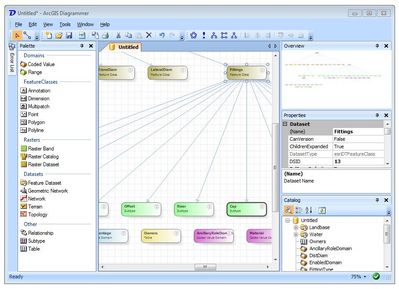

It is a report, but we required ArcGIS Diagrammer functionality where we can generate diagrams.

It is licensed version, and we can try in free version but required output would not be generated. We required Entity Relationship diagram (ERD) for GIS Datasets
