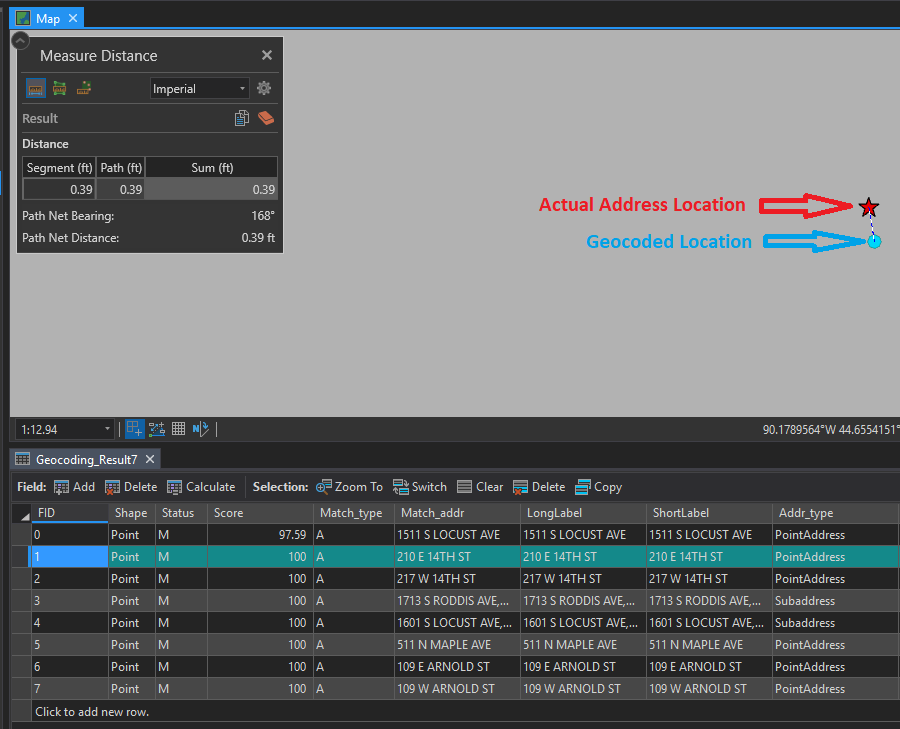

I created a locator in Pro using the "Create Address Locator" geoprocessing tool.  It was a "US Address - Single House Subaddress". Then I ran the "Geocode Addresses" geogprocessing tool against a table of addresses, using the preferred location type of address location, and checked the categories.
What I am seeing is the geocoder has matched all of addresses in the table with almost 100% certainty.  However spatially the results are off from the actual point.  The results are any where from .3' to a foot and half off.
I have checked the data from the source and the map are in the same projection.
I am a loss.  Should they not line up exactly?

Hi. Having similar issue.  Using the Pro 3.3 modelbuilder Geocode Addresses tool, I get results that are off by up to 100 ft or more.  If I use the ArcGIS Pro 3.3 Locate tool, the first result is correct, but geocoding using the same locator and addresses gives a different result.  Unfortunaly this case doesn't allow my results to be good enough.  Has anyone found a solution?  Thanks in advance.

I opened a case w/ ESRI (#03661884).  I was able to change the settings of the locator to get the desired results.   Here are some notes from my case. Hopefully this is helpful for you too.
  • Original issue:  The geocoded points do not fall over the reference data and has an offset ranging from 0.5 feet to 1.5 feet to in ArcGIS Pro.
  • Created a new locator using the "Create Locator tool" with the following parameters:
    • Country or Region: United States
    • Primary Table(s): E911Address_Points_Current_Cranston; Role: Point Address
    • Field Mapping: House Number: Address_Number; Street Name: Street_Name; Suffix Type: Street_Type_Suffix; Full Street Name: Full_StreetName; State: State
    • Optional parameters: Precision Type- Local Extra High.
  • The default precision type "Global High" has a precision of approximately 0.5 meter, which is consistent globally. Hence, we were getting an offset in the Geocoded result.  Instead use  Precision Type- Local Extra High.
  • Match with no Zones = 'Yes' and comprehensive zone matching = ‘No’ in the Geocoding options
  • Geocoded the "LocatorTest_E911PtsTable" with the newly created Point Locator, and the output feature layer did not have any offset and was lying on top of the original points.
