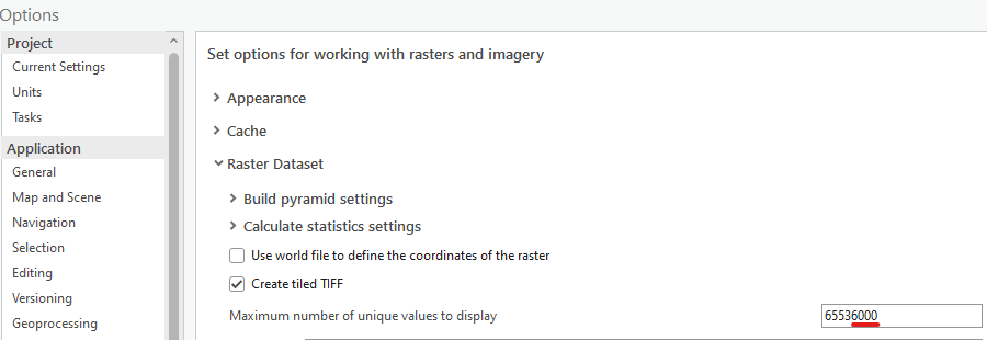

Classify is failing to run because unsurprisingly your float raster exceeds the default limits. In this case go to the options and change it, but what to? Doesn't matter chuck a bunch zeros after the number, I show what I did for my float raster below.
Go back to your symbology Pane, you will have to change Primary symbology dropdown to something else then back to Classify and hey presto it all starts to work. If it fails go back and add more zeros.
