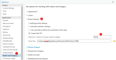

Hey everyone. I'm new to ArcGIS Pro and I've been following along an edX course on spatial analysis. Specifically, it teaches how to use bands to determine vegetation health. Anyhow, when I go to change the primary symbology to "Classify" on the ndvi layer I get this message: "The number of unique values in your data is greater than the set limit (65536). Edit the Maximum number of unique values to display, within the Raster and Imagery Options." In addition, the option boxes are empty.
I've tried what it suggests, going to the Raster and Imagery options, but it lacks details. There's also no attribute table for the layer. Help a newbie out?

it wasn't here?
... sort of retired...
DanielStratten
@DanPatterson is correct that that is where you would edit the number of unique values displayed. However, unique values shouldn't be at play here!

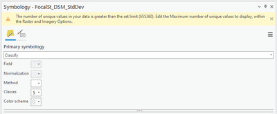

I'm seeing this error too when attempting to apply a Classify symbology to a floating point raster. Not sure why a unique value error is involved with a classified symbology. This is new behavior (to me) and looks like a bug.
DanielStratten
Screenshot of the issue below. Note 'Classify' symbology with unique value error.
